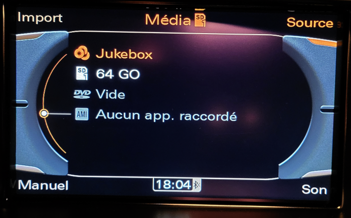

I confirm that the unblocker from DrGER is working perfectly, no problem with peripherals :
Gadget Font Technology Display device Screenshot
Font Screenshot Gadget Technology Display device
No need even to activate GEM, SWDL with coding ! You just need a 64(32)GB SD card and time.
