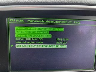

Hi @DrGER, I am sure that you have heard this lots of times, but I am really hoping that you can help me. I have a 2012 Q5 which was running HNAV_EU_P0206_D1 but had lost its navigation database, as in when I went to Navigation recently, after it previously working, it just said "navigation initialising" when I checked the software version and Nav.database version, nothing was displayed against the latter. I took the plunge earlier this week and first upgraded the firmware to HNAV_EU_K0257_6_D1, this appeared to go well apart from "map styles" which failed. However, when I have gone to upgrade the maps to 6.36.0_ECE as a user defined upgrade, as soon as it completes the first reboot it reports, "The device finished with error code 138" for all options of the map upgrade package.
I am using a 64GB SD XC card (FAT 32), which I have reformatted, and works fine for your "MMI-3G-Info-Main" script, so I am confident that card is ok (this is the third card I have tried, with each one seeing the same error). On the procedure I was following it recommended going into the GEM and deleting the Nav DB, but it says, /mnt/nav/db not found - no database to delete. I also notice when selecting List HDD Database Info, it says "no valid acios_db"
I have attached some photos and the ouput of your script, hoping that my issue will be glaringly obvious to you and that there is a simple fix (fingers crosed :))
