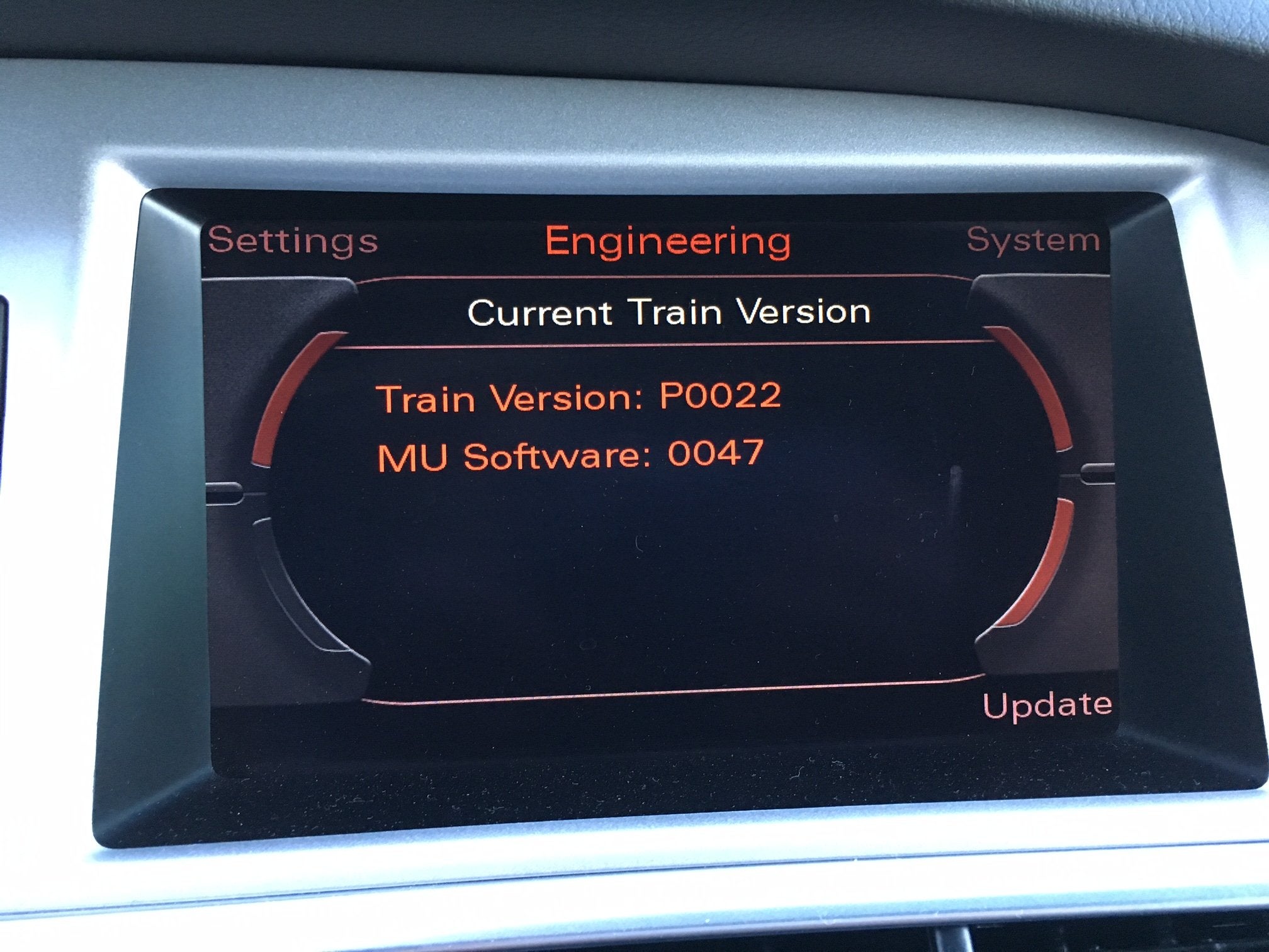

Hello boys long seuo this thread ...... I wanted to ask if you can perform this update on my audi a4. The part number is 8T1035652D
EU P0022 D1 software version. Tankyou
Hello Congo thanks for the reply. When I press setup + retrurn it appears version but comes out a message that says: WAIT INITIALISATION NOT YET TAKEN PLACE. When I go to make the diagnosis with vcds in 5F gives me a 'mistake DRIVE ERROR INITIALIZING. I'm sure someone has already tinkered with the maps because the car I bought it used and I found a sd card with a map loaded on but not working

Congo I am Italian ... my system does not bring the hard disk. Now everything works I have also activated the green menu. but when I try to start the upgrade stops at 2% and tells me ERROR IN READING
No use of windows seven. But in my diagnosis 5F I always ERROR INITIALIZING the problem started when the car battery has been discharged completely and I had to get it started, when a bridge with cables.
My version is P0022 MU0048
You used Mac OS to write SD CARD?!
in that case, you can use a small program called: Eject for Windows.
this will remove the typical OS X files Ă nd eject the sd-card or usb-stick.
