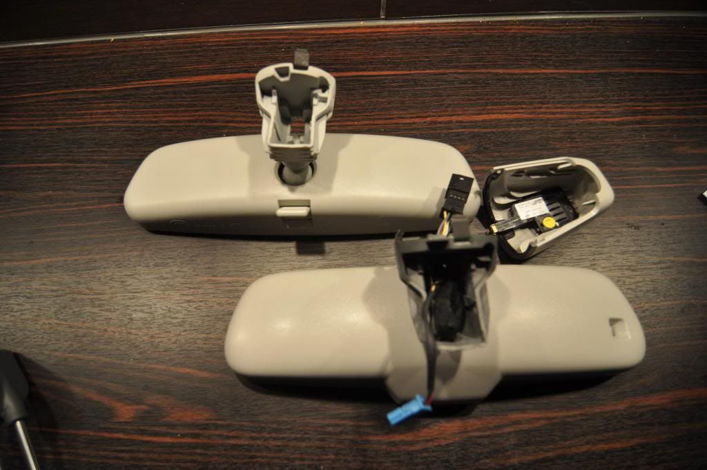

DarkA5:-
Remove your mirror from car. The long plastic piece that goes on the windscreen - prise is away carefully. You then twist the mirror surround that fixes to the windscreen anticlockwise and the mirror pops off, disconnect the connector.
Existing mirror:-
What you need to do is remove the bottom plastic surround from your existing mirror that houses your sensor (pic below), pull down on it easing it away slightly from the metal body with a screwdriver, it should pop off.
You will then see where a small blue connector is plugged into a black sensor in this housing maybe? Using a small screwdriver release the blue connector from this sensor within this surround.
Feed the cable back though the mirror and out. You then need to transfer this cable to the new mirror. That’s it done for your existing mirror.
New Mirror:-

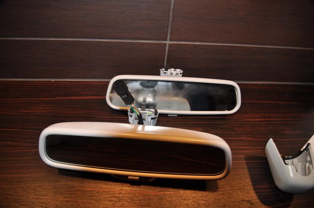

Take the surround off the new mirror as you did with your existing mirror.
Carefully prise away the black plastic block leaving enough gap to feed your existing cable through (with small blue connector) from behind the mirror.
Basically when you took the blue connector out from your existing mirror you want to put it back in the same way in the new mirror connected up to your surround you transferred over. (see photo).
Once you have done this and have both cables within the new mirror you then need to splice them together.
What I did is strip away carefully enough to expose the strands within the cable of your existing brown and red wires but not break the connector off the cable. Leave the purple/yellow wire –this is CAN wire not to be touched.
The photo below shows similar to what I have done but without the solder.
Cut the connector block off the 5 wires from the new mirror, you only need the black and white wires. Strip away the ends of these two wires to reveal the strands and wrap the black wire (ground) around the brown strands in your existing cable and tape up. Wrap the white wire (power) around the strands in your red wire and tape up. Then tape up all the wires and refit the mirror.
Pictures courtesy of Eclimax. Please study the pictures he has provided in his posts.
