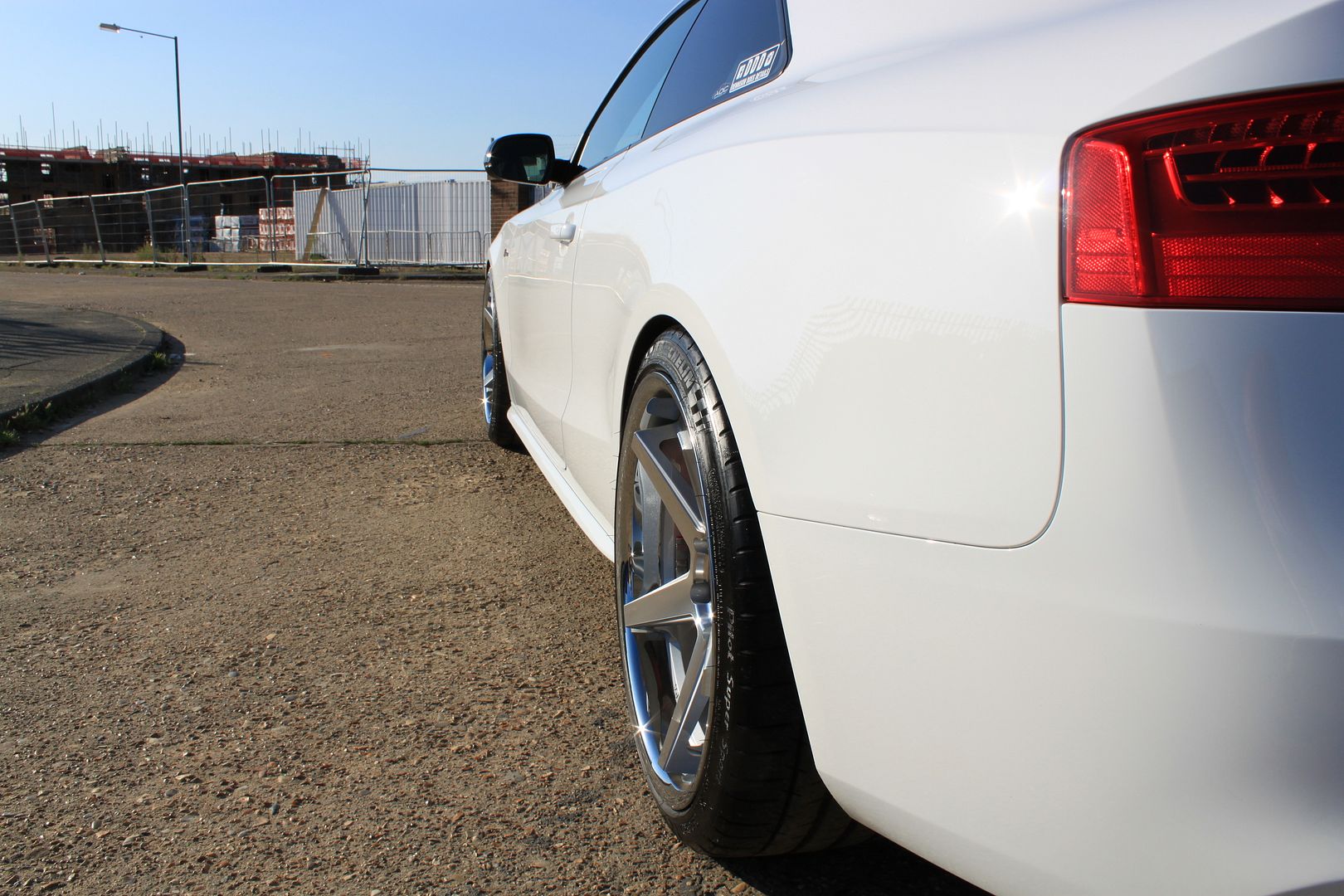

285 does have some stretch yes. See pic.

I wanted the fatter ones as I prefer the edge to be straight as possible. 255 will have a very slight stretch look to it but only if your looking for it ;)
