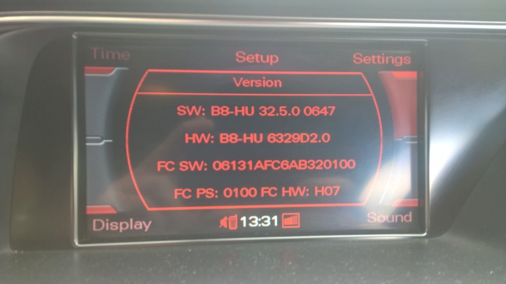

Software/firmware updating - investigating what it's all about. So I have this
which I assume is MMI 2G high from digging around on the net.
It seems my firmware is a bit outdated if 5570 is still the current version? could someone more knowledgeable confirm please?

Discussion Starter · #17 ·
With the weather being a washout in the morning so all chance of doing the brake lines was abandoned for another more dryer day. So i set about doing the firmware update, mine being the original version the car left the factory with.
Version 3250
Loving things which are fairly idiot proof i used this guide
MMI 2G software update to version 5570 - mr-fix.info
my satnav being MMI 2G High and i bought the 3 CD disc pack from my local Audi Dealer
The guide documents that all discs be removed from the front and rear CD players, what it fails to state is which player the update CD goes into... having nearly burned the planet down to the ground having used the Nav CD player in the boot and constantly getting CD not recognised, it suddenly dawned on me that maybe i should use the in dash CD...
(I did say i like things idiot proof... clearly i'm a special idiot!!!)
anyway having got the correct disc in the correct player...
it all started to download perfectly.
Disc 2 was done twice as i have inbuilt Bluetooth
and with the last disc downloaded we have
I have the battery charger plugged in to keep the battery levels high, it kept on coming up with low battery voltage, now as the battery is of an unknown age/condition I thought i'd swap it out for a known good one...
Still having the old A5 has it's uses as the battery is the same on the 3.0tdi and the S5, the battery on the A5 being recently new i swapped them over.... It made zero difference, so now another issue to investigate
