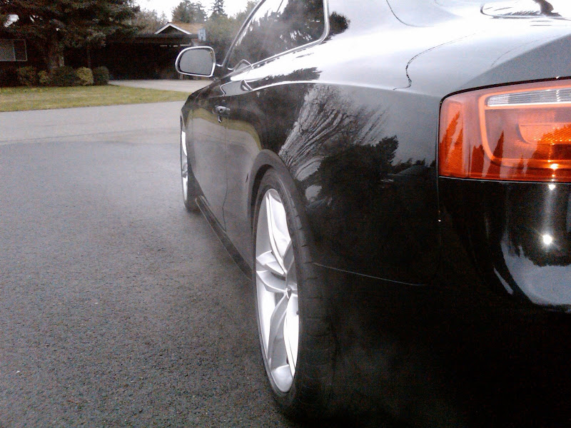

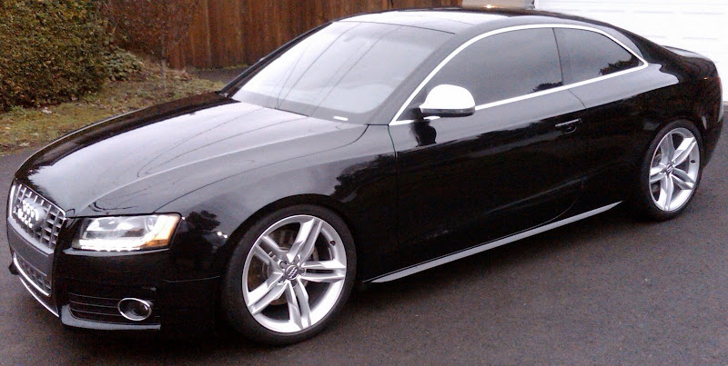

I know a lot of you are interested in seeing how the cars look when lowered, so here are some preliminary pics of my lowered S5 (using a BBerry Storm camera... meh). This is the STaSIS SL coilover kit with Ohlins dampers and Eibach springs. Spring rates are 700lbs in the front and 400lbs in the rear; with the rear bar, the effective rate in the rear is nearly 700lbs. STaSIS allows you to pick your spring rates, and I went with 400lbs in the rear for practicality's sake (hey, I have a baby in the back, so this can't be a go-kart).
This drop is so aggressive - almost 2" in the front. This is too low for me and I'll be raising the ride height this weekend. Apparently, I didn't set the ride heights properly (despite excellent instructions from STaSIS) and ended up with a dumped look that isn't practical - my fault. It rubs like a belt sander and I easily hit the bump stops. I have H&R spacers on the stock wheels; 20mm front, 25mm rear. I'll do a performance review once I get it dialed-in properly, but my initial impressions are that it's awesome. Better feel, much faster turn-in and responsiveness, far less understeer, better balance, and easier throttle steering.

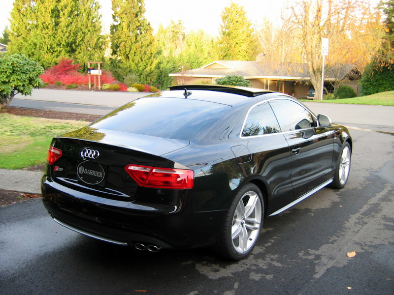

^^Stock 4x4 ride height for comparison^^
The tuck is awesome:
You can't see the negative camber issues in this pic, but it's a function of the too-low ride height (again, that's my fault). You can also see how the tire just crawls up into the fender. Cool, but just too aggressive:
