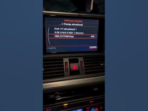

I have a problem.
What can be the reason that when updating the MMI, as the update of a particular module is made, progress is made and every now and then with random percentages, e.g. 20, 33, etc., no matter what module it returns to 0% and starts again.
Some modules like it starts again from the moment it finished but the KBD_FC7 module can't go because it keeps going a bit and starting from the beginning.
Tried 2 memory cards and same thing.
What is reason?
Here Video.

for me it looks like an sd card problem, has you use the format 32 default 16kb and slow doing!
if yes, then maybe the download file are corrupted and dont use an mac pc for it, only windows pc for all
60 Posts
16.xxx ==> 16kB
you are at the moment using 32kB
test it with 16kB
every body are doing it via SD card, as far as I know DVD are used for Maps update
I personal are only using SD card with 32GB this give less problems!
