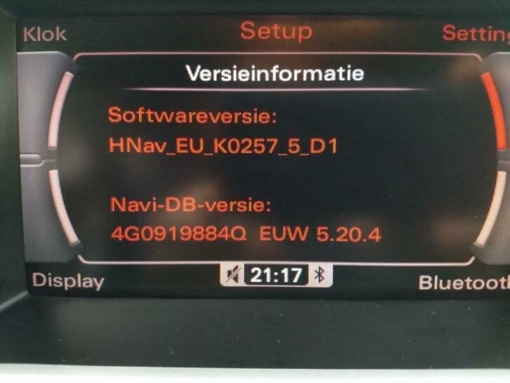

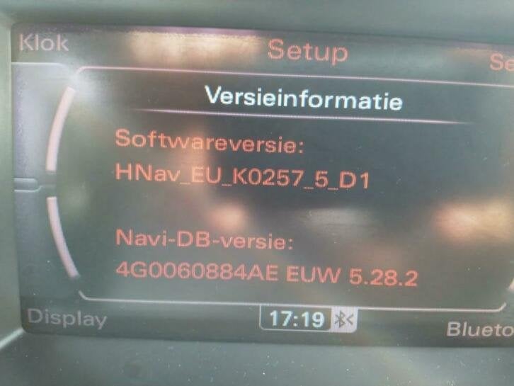

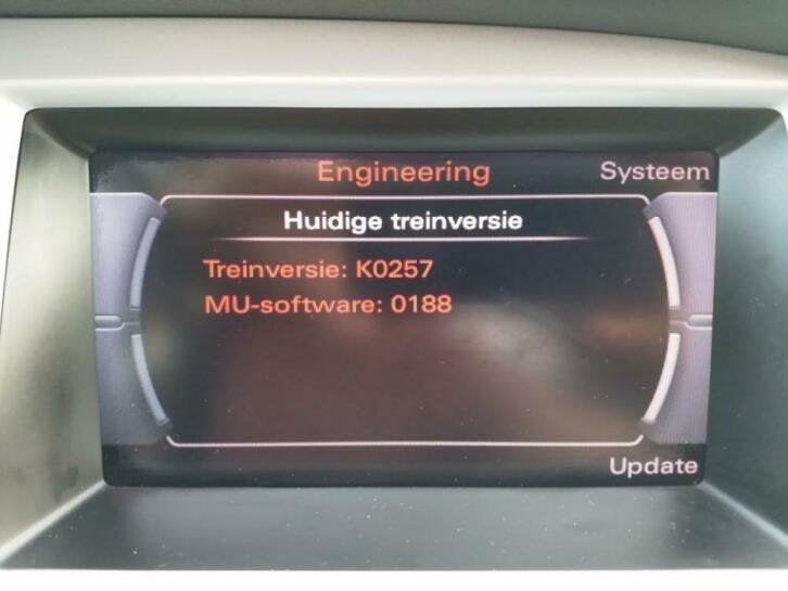

Hey all, I need advice.
See attached photo's.
A friend is running 3GP HNav firmware with map MMI-3G-Basic-West-Europe.
Yes, very strange. He says, he bought the car in this state with the Hnav firmware already in it.
It is for sure a BNav device, because a HNav firmware update isn't accepted by the system.
Now we want to update the BNav map to 2019.
The MMI accepts the 2019 3G Basic map, but it gives the 'blocked' message. It's need to be activated.
To activate it with the script the firmware needs to be on K0260.
Do you think we can safely update the firmware to BNav K0260?
Will the MMI remove the Hnav firmware and install the BNav K0260?
Or should we leave it like it is and activate it with a different script, and so which script?
Thanks for you advice!

3g basic maps but hnav firmware
this topic is for MMI 3G Basic.
but the MMI of your friend is a MMI 3G high.
so, you are in the wrong topic and you have the wrong MMI in mind.
hi @fred44nl,
To my knowledge it's a 3G basic MMI and someone hacked the Hnav firmware on it.
The MMI doesn't has a hard drive either.
The 32GB Hnav 2019 maps doesn't lead to anything when inserted in the MMI.
A version conflict occures when trying to upgrade the firmware with HNav_EU_K0257_6_D1 (he is on 5_D1).
The MMI runs 3G Basic EUW map on SD ( 4G0919884Q EUW 5.20.4). When removing the SD with the map the navigation stops working.
The MMI accepts the 2019 SD with EUW_Ba_R_5.28.2 and now the map supose to be activated with script Audi_3GB_Fix_K0260
See the attached photo's in the previous post.
Can the HNav be undone by updating the firmware to BNav_EU_K0260_1_D1?
Will the MMI remove the Hnav firmware and install the BNav K0260 only?
Or should we leave the Hnav firmware on it and activate the EUW_Ba_R_5.28.2 with a different script, and so which script?
