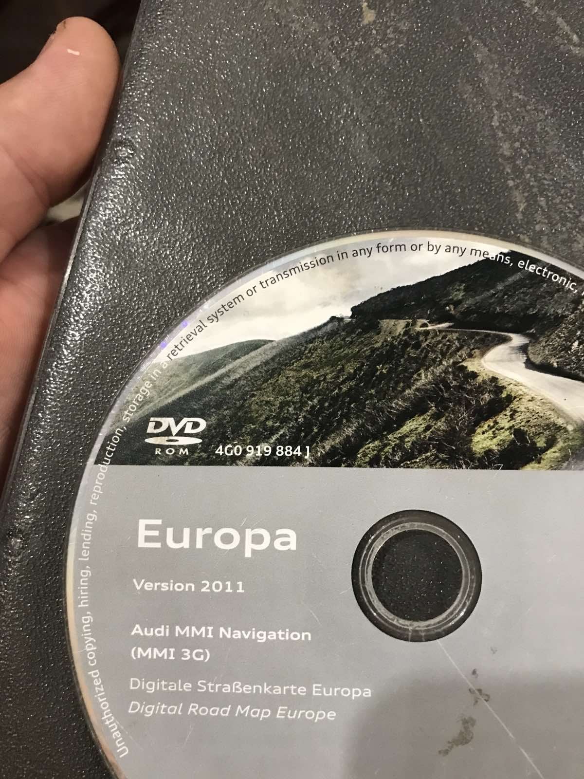

I have a 2011 Audi q5. mmi 3g basic.
I installed the latest firmware, and updated the maps, activated them, worked for a week and then writes "Checking the data carrier. Please wait ..." I have already changed different versions of cards, from a flash drive and from a disk - the result is the same. Firmware - K0260. Navigation version. databases - empty They say on the forums a native disk can help, but only I can't read it. (scratched) MMI 3G Basic 4G0919884J 2011 is a native drive
Can someone share in exactly the same way? (Copy disc) Thank.
