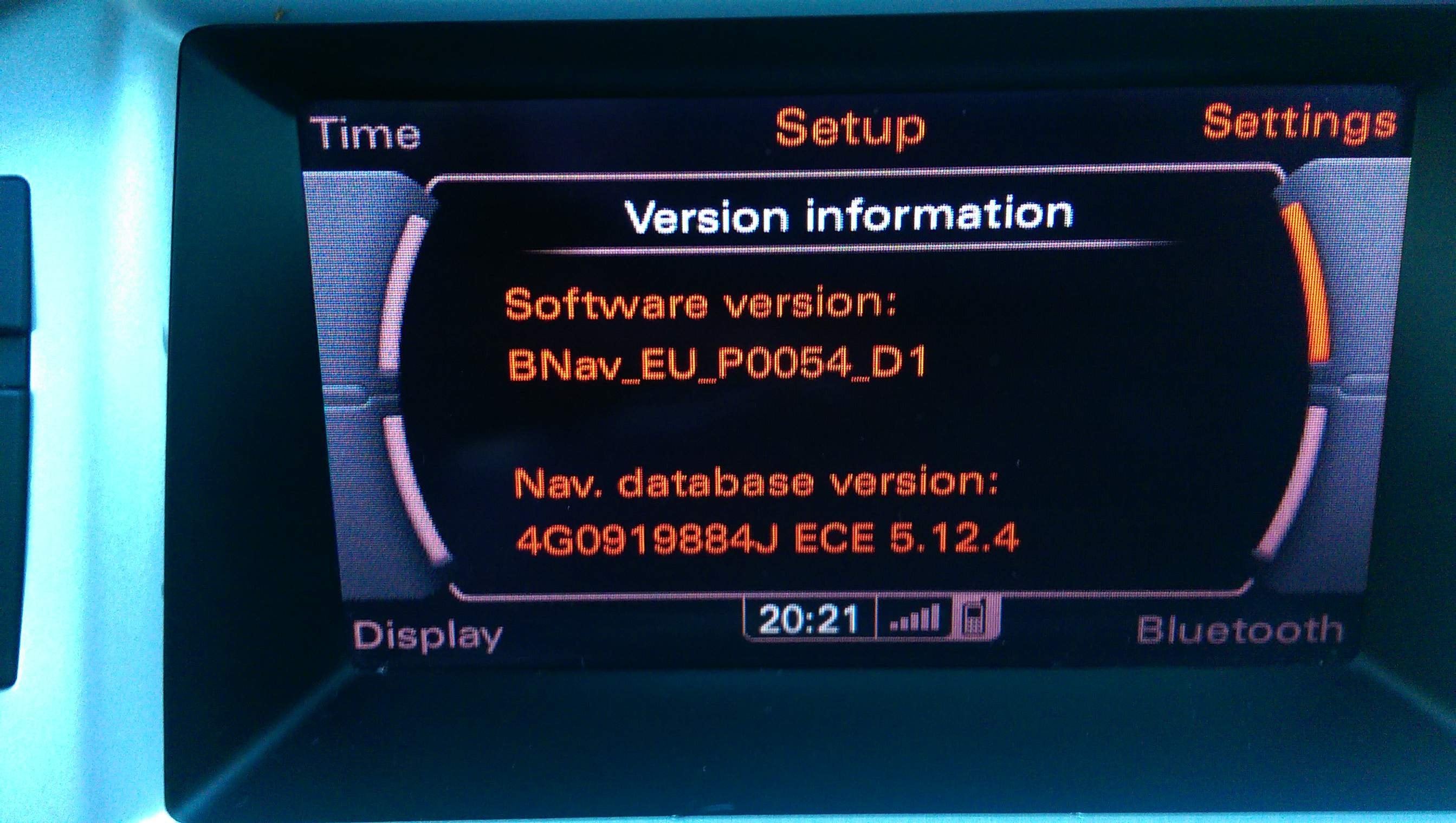

Hey Congo,
thanks for the great instructions etc. :thumbsup:
one question though, I have the Bnav with DAB and Bang and Olufsen, does this mean I have to do anything different or is just as per the guide?
I'm currently showing as..
Software - BNav_EU_P0054_D1
Nav. Dbase version - 4G0919884J ECE 5.12.4
Cheers
Steve

It's better to exclude the B&O from the upgrade (look at the guide for 3GP - Bose section ) for the DAB I will look to see if I have separate firmware. Odd configuration though, never saw B&O with basic nav :) there is a chance the bass to become less powerful after the upgrade if you don't exclude it.
