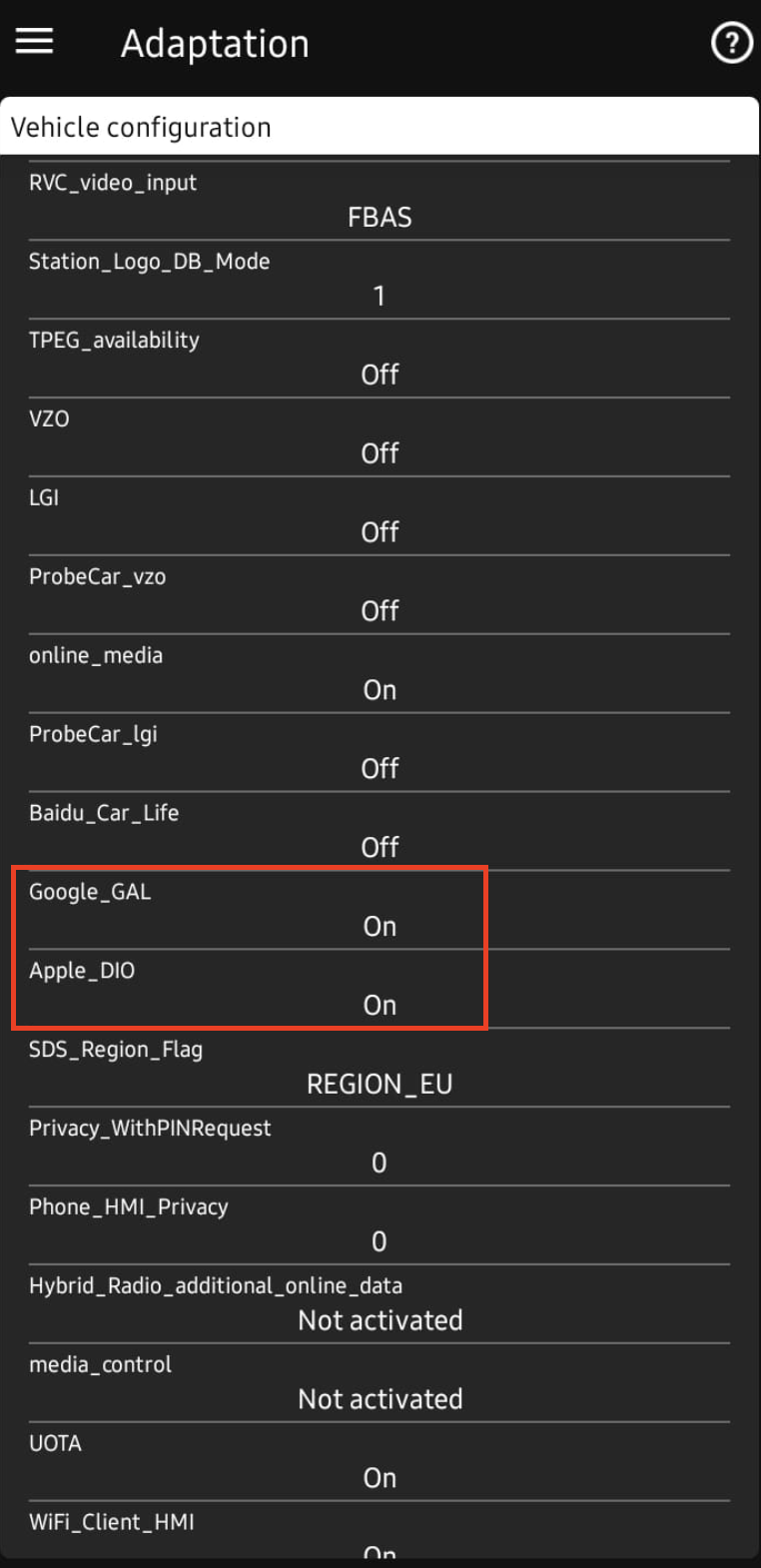

First of all, thanks for the @congo activator!
I have a 2017 Audi A3 8V with MMI version MHS2_ER_AU_P0470 0191 and was able to activate it successfully.
It had the Charge Only port, I bought the "5Q0 035 726 E" module with the appropriate wiring, and proceeded with the installation to activate CarPlay/Android Auto.
I coded with ODB11, Media 5F, (apple_dio = on, google_GAL = on, and byte 19 with usb_ipod).
Restarted MMI, plugged in my iPhone with iOS 18.5, and nothing happened...
Plugged in my Android phone, and Android Auto started!
Any clue why? I've used CarPlay on my iPhone in other cars, and it worked...
Best Regards
