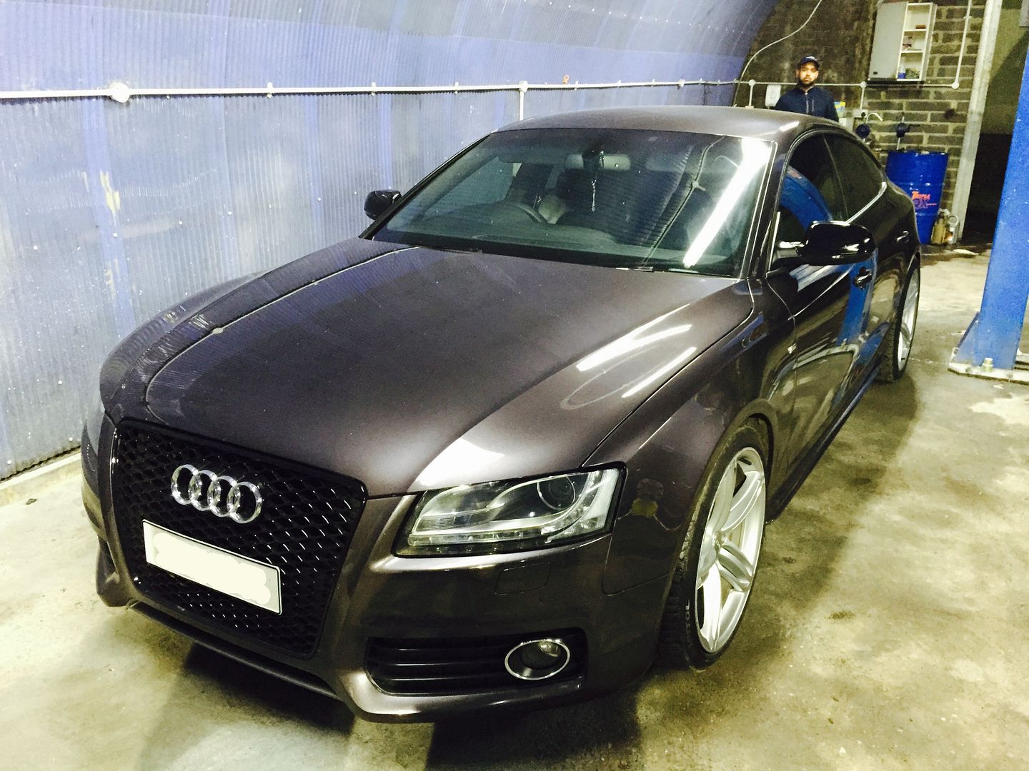

The next thing i did was upgrade all the lights in the car to LEDs, including the 3 lights in the boot. Since some of the lights in the A5 are not the same as the A3 i had to order in a few more bulbs from @t8ups and installed them as soon as they arrived. I also changed the footwell lights from the dim white LEDs to lovely red LEDs so that when I'm driving around at night the ambient light is a nice dim red over the feet.
The next day i had to drop off a customer to Bluewater while i had his car in the garage and as i was walking back to the car the front end of it just didnt look right, it looked.... standard. I had to do something about it so i called up another contact and placed an order for a special part.
I also called up TPS and ordered a pair of Audi LED number plate lights, then got in contact with the guys at HIDs Direct and ordered some 5000k replacement D3S bulbs and foglight bulbs.
Its really difficult to get decent pics of the headlights with an iPhone but here is what it looks like with the uprated bulbs:
Then while the car was in the garage and my special part turned up earlier that morning, i got to work and went from this:
To this:
The front end has been transformed from just a grill change, much happier with it now.

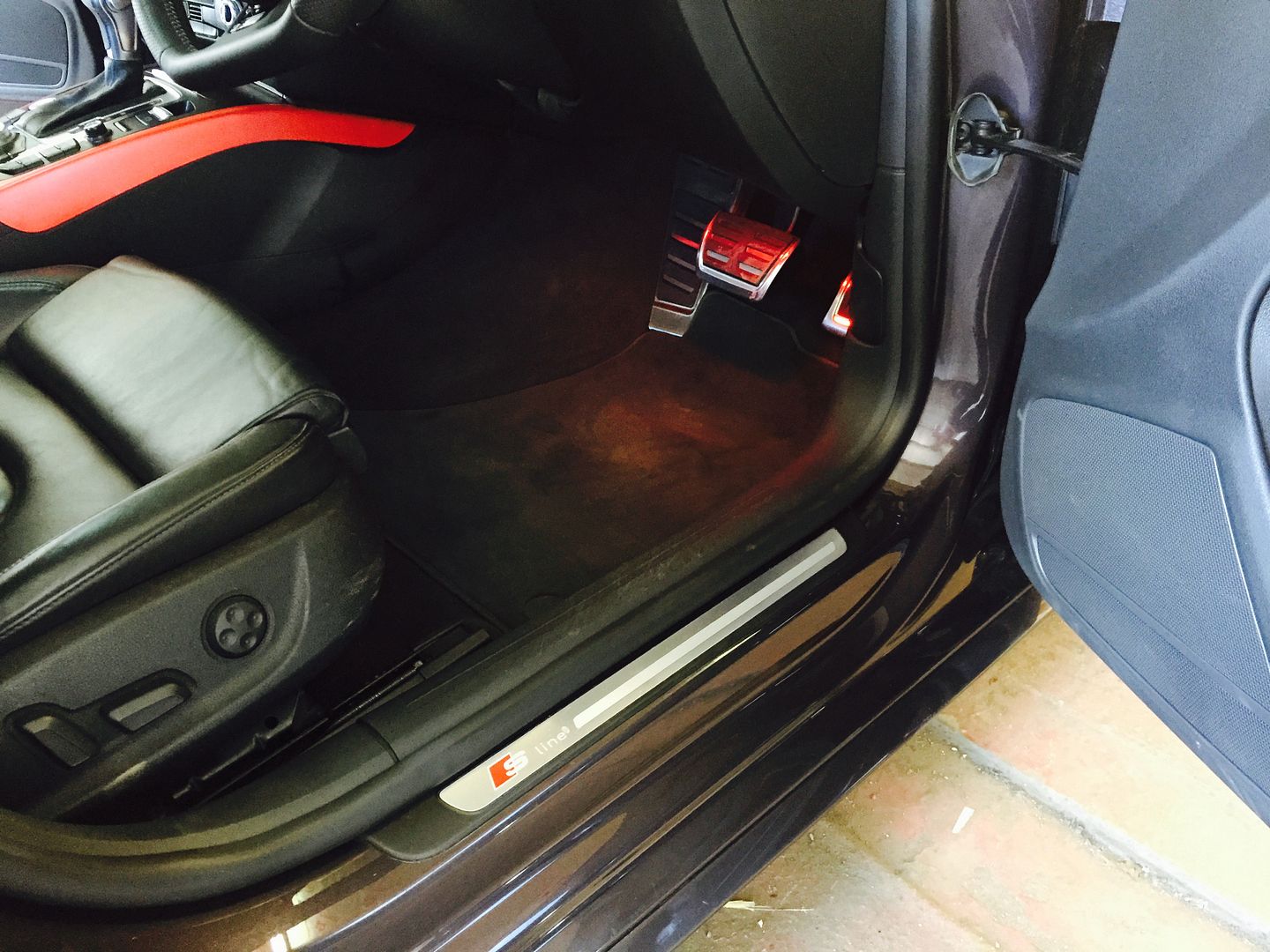

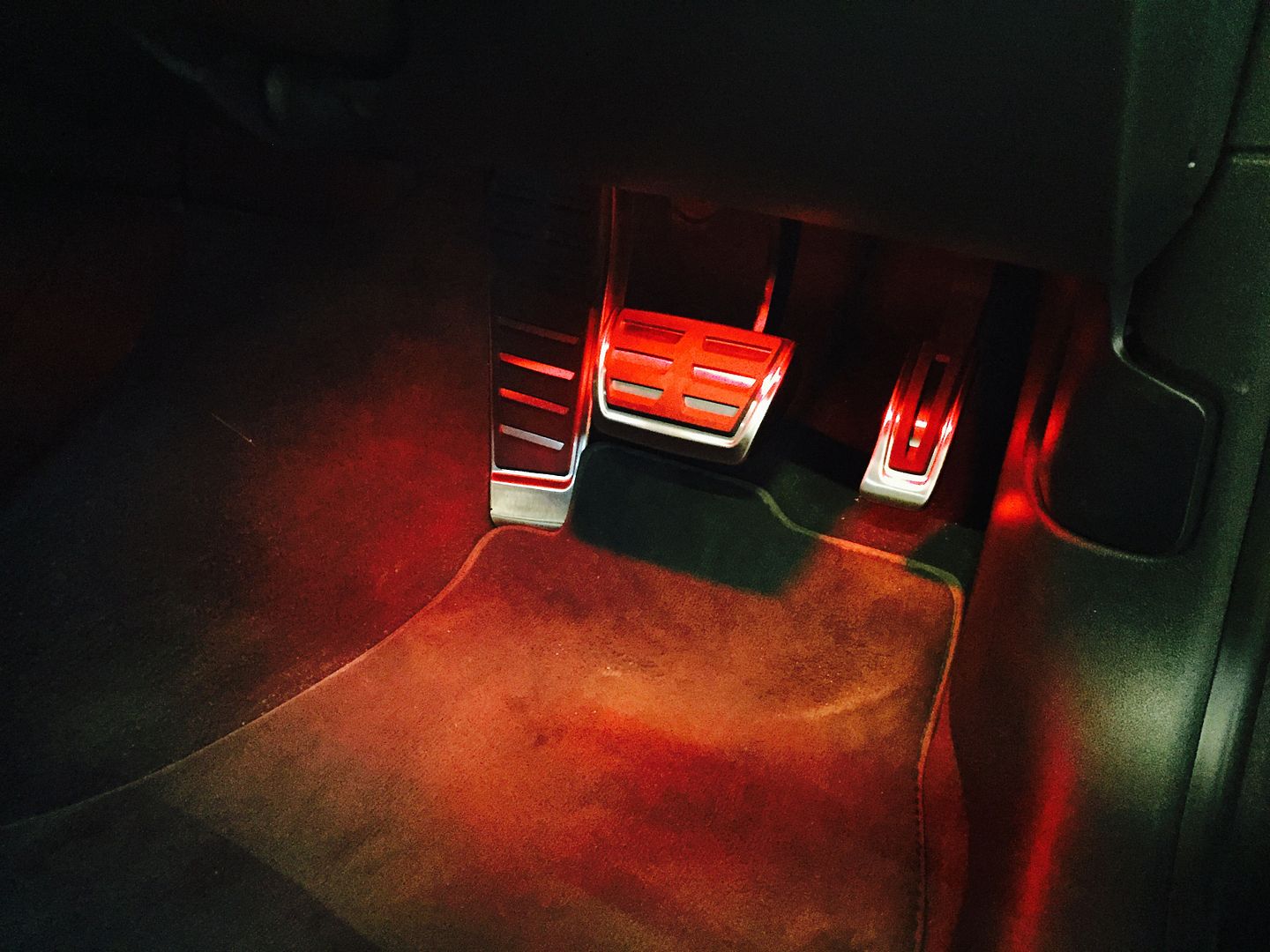

So i had a free day today and i got to work on another little mod... the ambient door pockets.
Now after reading all the guides it says that it should plug into pin 8 on the door modules
however my door modules don't have a pin in pin number 8 even though the car came from factory with the interior light pack.
Now i looked around and saw the part number for the recommended door module has the pin in pin 8 but its an 8K0 number which as far as i know are for older A4 models, my door modules are 8T0. Also since my car has the advanced key with the door sensors i didnt want to change over the door modules so i just wired the pocket lights into the interior door handle LED which works perfectly. a little annoying as i cannot control the brightness but its still looking good... anyway here are the pics.
Drivers Door:
Passenger Door:
And what the car looks like with the doors open at night:
I have also done the rear doors, just didnt grab any pics as they look the same as the fronts
