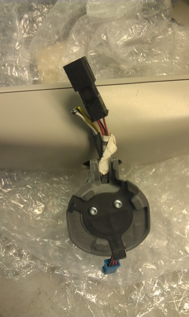

Third zone sensor and cover from original non auto dim mirror. This just snaps off the mirror with a little spreading and pulling. Remove both mirror's covers.

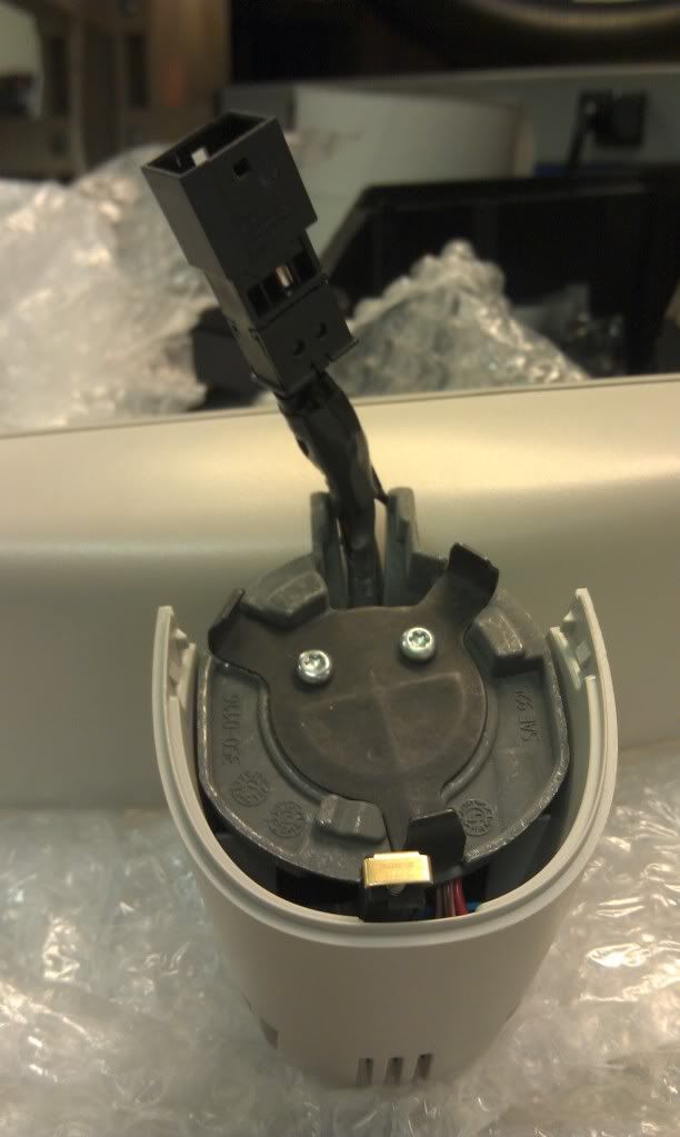

New mirror with compass sensor
You can see I routed the original plug around the compass sensor
Now the original cover and sensor around the new mirror and compass sensor
